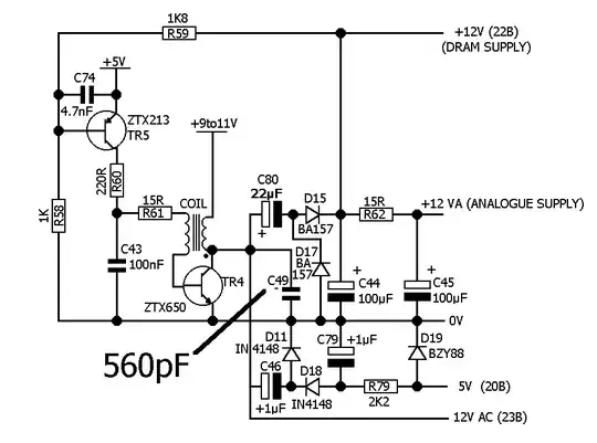

The method is to use an internal DC-DC boost converter. It's depicted here:
ZX Spectrum internal DC-DC converter NOTE: signal labelled as 5V (20B) is actually -5V (20B is the pin at the rear connector where this signal is available)
It is essentially an inverter circuit. TR5, TR4 and the coil forms the inverter. It generates a pulsating 12V signal at the collector pin of TR4 (it comes from the reactance discharging through transistor TR4). That signal is AC coupled by C80, so we have something similar to a 12V AC power supply, of about 110kHz, at the right side of C80.
D15, D17 and C44 form a simple rectifier and a simple filter. As frequency is much higher than 50Hz, no full rectifier or big capacitors are needed in order to have a steady power supply. The junction at D15 and C44 carries a 12V DC signal suitable for DRAM chips.
The same voltage is passed through a PI filter formed by C44, R62 and C45 to give another 12V supply rail, isolated from the first one. This isolation (achieved in some way because of the PI filter) is needed to avoid high frequency switching noise coming from DRAM chips to enter the video circuit section, which would make it display on screen, degrading picture quality.
To generate -5V, a similar circuit is used: from the same point the 12V supply is got, another capacitor, C46, gives a 12V AC signal. Diodes D11, D18 and capacitor C79 play a similar role to D15, D17 and C44. Only that this time, diodes are arranged in the opposite direction, so the output signal is negative (with respect to ground). D19 is a 5.1 Zener diode, which is used to lower the voltage from -12V to -5V. In order to not to destroy the Zener, a current limiting resistor R79 is used. The -5V supply is very weak and only used to polarize the substrate of DRAM chips.
This particular DC-DC converter is the cause of many broken Spectrums. It happens that 4116 DRAMs (the ones that need three different voltages and forms the contended memory block) require them to be applied in a very specific order - an order that the DC-DC circuit doesn't respect. If the order is wrong, there is a chance that the DRAM memory is damaged. Without the contended memory block in working order, the machine cannot boot and the ROM hangs the computer. The user doesn't see the (C)1982... welcome message, but a screen with light gray, white and/or black vertical thick stripes. The pattern may vary. The border is always white (light gray actually).

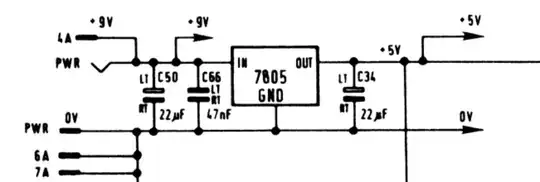

This is the boring (or, rather, the trivial) part of the answers - How the +5V voltage is being generated in a ZX Spectrum:
The ZX Spectrum uses (like basically any other home computer of the time) a linear regulator (7805) and some Cs for smoothing the voltage to generate the 5V. The +9V fed into the circuitry are produced by the external PSU brick. The only interesting fact to mention is the DC brick's plug polarity - While nearly anyone else tends to use barrel plugs "positive centre", the Spectrum has it the other way round ("negative centre"). As there is no reverse polarity protection circuitry in the Spectrum, watch out in case you want to use a replacement PSU! You might use it only once...
The main downside of the 7805 linear regulators is they simply "burn" the excess energy from the PSU and so tend to produce a lot of heat in the Spectrum. While the excess heat is very well absorbed by the large heat sink on the 7805, today's state of the art technology is more advanced. Many people (including myself) have thus replaced the 7805 with a modern switching regulator replacement (Traco Power TSR 1-2450, for example, but there are lots of others) that does the same job with about 90% efficiency, produces much less heat (practically nothing) and puts much less strain on the power brick - and less heat strain on the other Spectrum components. It doesn't even need a heat sink anymore.

  • I'm curious; where did you get that image from? – wizzwizz4 Feb 05 '17 at 10:46
    @wizzwizz4 cut out from the ZX Spectrum Service Manual. Have the original on paper, but never got around to scan it. So can't remember where I got it from, could have been here: https://k1.spdns.de/Vintage/Sinclair/82/Sinclair%20ZX%20Spectrum/Circuit%20Diagrams/ – tofro Feb 05 '17 at 10:49
