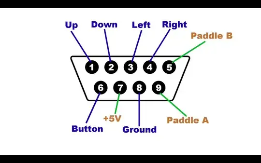

As pointed out in The 8-bit Guy's video, How Vintage Game Controllers Worked, from 2:08 onwards, all of the pins on the DB-9 plug were used for the joystick and the paddles:
C64 DB9 pinout
So, I guess that you could have used pins 5 and 9 for additional buttons - if you had a custom controller and software that could support those additional buttons.

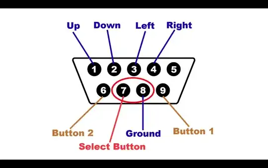

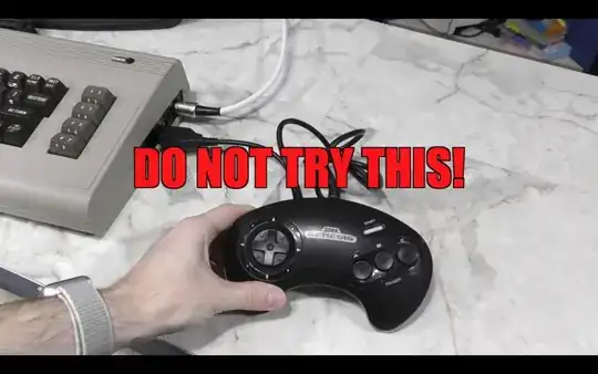

Important note - How to fry your C64...
by using the Sega Genesis controller, shown here,
This particular controller had the Select button wired to pin 7, which (as shown above) the C64 used for +5V.
Sega Genesis DB9 pinout
So, if you connected a Genesis controller to the C64 and pressed the select button, you would short the +5V to GND and fry the C64.
