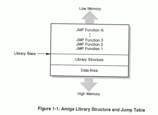

@RichardDowner has already answered it, but who don't want pictures? These are from the Amiga ROM Kernel Reference Manual: Libraries, 3rd edition, @1992 by Commodore Electronics, Ltd.
Figure 1.1: Amiga Library Structure and Jump Table
What Every Amiga Programmer Should Know: The functions in the Amiga OS are accessed through shared run-time libraries. Libraries must be opened before their functions may be used. The systems master library, Exec, is always open. The exec function OpenLibrary() is used to open all other libraries.

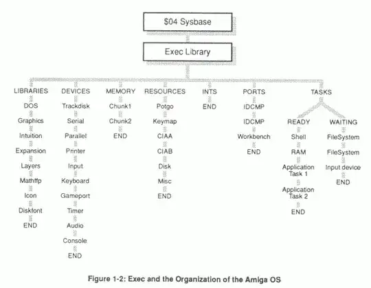

Figure 1.2: Exec and the Organization of the Amiga OS
What Every Amiga Programmer Should Know: The Amiga has a dynamic memory map. There are no fixed locations for operating system variables and routines. Do not call ROM routines or access system data structures directly. Instead use the indirect access methods provided by the system.
If I have a different kickstart version,
could the entry points in exec.library be different?
With the one absolute entry point at Sysbase, no, it won't be. Everything else is relative and should be accessed via library calls.
