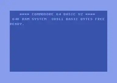

The Commodore 64 suffered from a strange bug that caused it to lock up when typing in the full-screen BASIC editor. To trigger the bug, position the cursor on the last line of the screen, type enough text (or even just spaces) to scroll the screen by two lines, and then hit the DEL key while the cursor is on the first column. The following text then gets printed to the display:
                                       L
OAD
?SYNTAX ERROR READY. RUN
READY.
A flashing cursor appears after the last line, but the system is apparently unresponsive to all input, including the usual RUN/STOP or RUN/STOP+RESTORE.
animated screenshot showing the above-noted bug
The problem, and various workarounds, were briefly described on page 12 of the September 1985 issue of COMPUTE!'s Gazette:
The bug does not affect the portable 64 (SX-64), and newer models of the 64 have been revised to eliminate the problem.
The lockup will occur only when the cursor is red, cyan, blue, yellow, light red, dark gray, light blue, or light gray. Safe colors are black, white, purple, green, orange, brown, medium gray, and light green. To avoid the problem altogether, change the cursor color to a safe color before you start programming.
Also, you can defeat the lockup if you own a Datassette. After the computer freezes, simultaneously press the left SHIFT key and 3, or X and 5, or V and 7, and so on (every other key from left to right). The screen will display PRESS PLAY ON TAPE. Press PLAY on the Datassette and then RUN/STOP. Disk drive owners can totally avoid the bug if the first line in the program in memory is OPEN15,8,15: INPUT#15,A$.
The behaviour of the bug, the exact conditions under which it occurs, and the workarounds are all so bizarre that I'd like them all to be explained. In particular:
  1. What is the underlying cause of the bug? I assume that this is a problem in the operating system (KERNAL?) in ROM rather than the hardware itself, so where exactly is the affected code and in what way is it defective?
  2. Why does using certain cursor colours avoid the lockup?
  3. Why does pressing left SHIFT and 3 (or every other corresponding pair of keys on the two rows) and then starting the Datassette break out of the lockup? (And how on earth was anyone able to come up with this solution? Unlike the previous workaround, this isn't something that could have been discovered through trial and error.)
  4. Why does having OPEN15,8,15: INPUT#15,A$ as the first line of the program in memory avoid the lockup?
