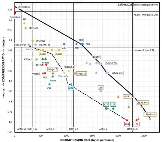

About packers since the '90s till nowadays, here is a visual comparison of all known compression algorithms on the ZX-Spectrum alongside 7zip on PC:
introspec's latest compression chart
