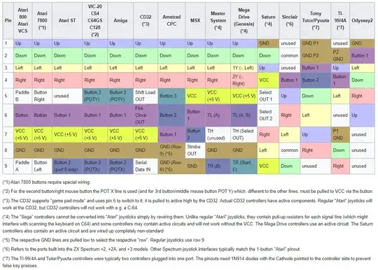

This table from Wikipedia's page on the Atari Joystick Port showing the pin assignments of various systems using a 9-pin input port will be of use:
Broadly speaking: Atari and Commodore form one compatible group, Sega Master System and Mega Drive (Genesis) form a second group, and everything else is mutually incompatible.
