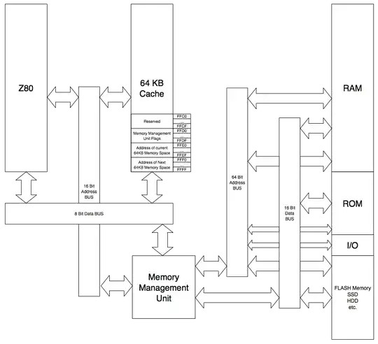

I'm in the middle of making an 8Bit computer, I've selected Z80, the 20Mhz version, which is cheap and readily available. Since Z80 has a 16bit address line it can only address 64KB of memory location. 64KB is not a lot, so I decided to design a memory management unit using an FPGA (I'm not sure what to call this logic unit, for now I can only think of MMU) to expand the memory space.
I have connected a 64KB fast SRAM directly to the 16bit Address BUS of Z80, and placed it next to the CPU, It is serving as a cache for Z80 very nicely.
When the computer boots up MMU copies content of a 64KB ROM, which has some basic OS, and some goody software I have written in assembly, Z80 happily reads the cache and executes the instructions, which is good, (things are working correctly).
I have reserved the last 64 Bytes of the cache as the following diagram:
Which is divided equally intto four parts, in the lower part I put the 64bit address of the memory I want to access, and on top of that there is the 64bit address of the current 64KB copy of the memory in cache, on top of that there are some flags for the MMU which is used to see if Z80 is done with the current contents of 64KB cache, wants to access some other 64KB code+data from memory, wants to read to memory, or write to it, etc. The MMU checks these flags and makes the appropriate decision, accesses the requested memory address and fetches the data and puts it into cache.
The reason I have chosen a 64Bit addressing is to keep my option open, and keep the possibility for future expansion, also I wanted to be able to address memories larger than 4GB. Like RAM, SSD, Flash Drives, SD cards, HDD, etc.
I have programmed the MMU to always listen to 16bit address BUS, so It can make quick decisions, for example, Whenever Z80 wants to access a 64bit address it writes the address into the bottom 64bit of cache, when it accesses $FFFF it means the Z80 is writing the last byte of the 64bit address so MMU knows that it is time to fetch some data from that address in the given memory address, fetches it and copies it into cache. So far everything is working correctly.
But I am not entirely sure I have gone the right path, to be I honest I'm not sure where to go from here. The main question that is bugging my mind, are potential bugs that I might introduce, and also performance.
There are some problems I haven't come up with a straight forward solution yet.
for example what if Z80 wanted to only address some small part of the memory while executing code in the cache space, maybe an array or a variable, What should the MMU do? should it simply copy that data and put it in cache? what if there is some important code or data on the replicated address? should I reserve some memory in the cache for this? Or should MMU simply keep the data in some registers or some perhaps external temporary cache and send it over the data BUS to Z80?
What if there is a large data structure or an array in memory that Z80 wants to access? What about loops, functions, specially loops that frequently access a different part of the memory?

    I'm not sure if this really fits the RC.SE format, as it does not ask a specific question, but solicit for opinion about that design. – Raffzahn Apr 07 '21 at 18:42
    Having said that, my very first question would be why on earth any hardware control needs to be located within memory address space. It's an x80, it got a dedicated I/O address space of equal size, RAM should be left to code and data. Not to mention that this is as well the point were any kind of process encapsulation can easy be added. Managing code and data with a single 64 KiB window is cumbersome. It needs constant reloading, making the design extreme slow. A design sweet spot is to maintain code, (global) data and data for arbitrary A=B*C operations with minimal management. – Raffzahn Apr 07 '21 at 18:46
    That is a question of making new hardware, not about retro hardware, I presume it is closed soon. Your term "cache" for the SRAM makes also no sense, the MCU does not execute stuff by just wrapping around a 16-bit memory space time after time. SRAM could be left out and let the FPGA do the paging. 64-bit address space makes little sense as you generally don't access things like files or SD cards or HDDs as linearly mapped memory devices, they traditionally work in 512 byte sectors. – Justme Apr 07 '21 at 18:49
  • @Justme I realize that my design is not conventional, and you might be right leaving the FPGA to do the paging. Should I discard this and start from scratch? Or make some changes? – ilgaar Apr 07 '21 at 19:06
    @ilgaar This is a Q&A site. I don't think it is on topic to ask opinions how you should continue with your hobby project. While it does look cool, I think the Z80 will be a bottleneck handling all that hardware. I mean, it kind of resembles a modern laptop or Raspberry Pi, but with the CPU swapped to 40 year old 8-bit model – Justme Apr 07 '21 at 19:26
    Might be worth looking at how historic machines such as Amstrad CPC6128 or ZX Spectrum 128 did it. Generally a fixed windows was used in addressable ram, into which different parts of the extra memory could be 'swapped' via writing to an IO address. See http://cpctech.cpc-live.com/docs/rampage.html for details of the Amstrad approach. – Mark Williams Apr 07 '21 at 19:33
    Or use an eZ80, which combines classic Z80 code with 24 bit address space - more than enough for a CPU that size - as here Zilog already solved that issue in a quite compatible way. – Raffzahn Apr 07 '21 at 19:35
  • If you’re going the FPGA route, why not integrate the “Z80” cpu into it, including any enhancements needed for a larger address space. I don’t think the concept described in your question will be very practical or useful. I would look at separating code, stack and data space and implement “8086-like” segmentation, like described by @Raffzahn. – StarCat Apr 08 '21 at 07:23

What Does This Mean to Above Z80 System?
Handling all random access as complex 4 byte (64 bit) maniputaion may make a 20 MHz Z80 slower than a ZX81. So before thinking about implementation ataking step back and thinking about ISA and usage would be a good idea. And while the above 6502 based solution might be as well doable (using MM1 instead of SYNC), the Z80 opcode space is less open, so extensions may need additional thoughts.
In any case, a look at the eZ80 might as well be helpful (I may add it to thist later on).
