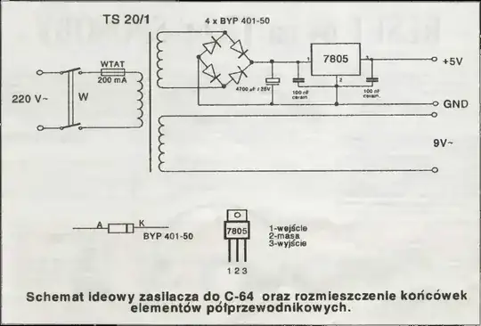

In Poland there was the Commodore & Amiga magazine in 1992-1995. In it's 7th number (July '92, pages 22-23) there was an article on how to build your own power supply for C64 written by Jerzy Dudek. There is an archive of this magazine at http://stare.e-gry.net/czasopisma/commodore-amiga. It's in DjVu format.
Here is the schema from this article: C64 power supply schema

    That's a very simplistic power supply. Which is fine. I like simple. However, I would recommend something with a little more over-voltage protection. One good solution is the Sav64. http://www.lemon64.com/forum/viewtopic.php?t=63219&highlight=sav64 It's not a power supply itself, but it can sit between the PSU and the C64 and provide better protection from over-voltage. – cbmeeks May 25 '17 at 12:30
    Adding to what cbmeeks said above, 220 V to 9 V should be a transformer turns ratio of about 49:2 (24.4:1). With that, even 240 V on the primary (which is well within tolerance; in fact, my UPS is reporting 239 V AC mains right now) will give you a shade under 10 V AC. The 7805 should provide sufficient regulation on the +5V DC side, but having the AC side completely unregulated would give me considerable pause. FWIW, my UPS is set to the most sensitive setting, and triggers "high voltage" at 288 V AC on the mains side; that'd give you almost 12 V AC on the secondary. Will the C-64 enjoy that? – user May 27 '17 at 19:06
