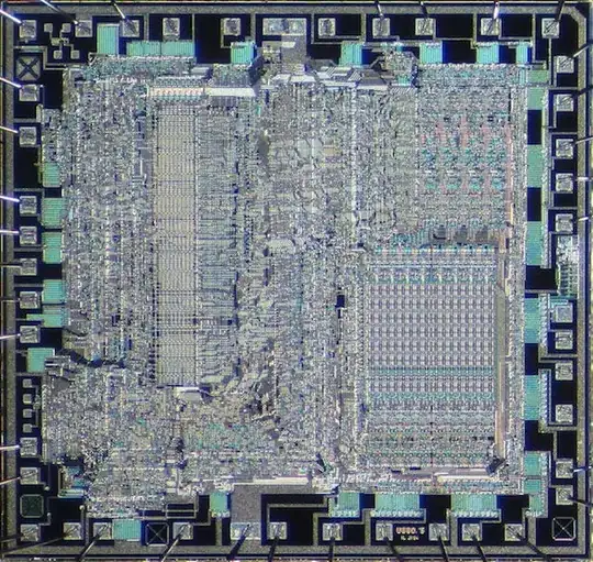

You could reverse-engineer those early CPUs by grinding or etching away the top (plastic) layer of the chips down to the silicon die and examine the chip structures on an (optical) microscope.
Z80, microscopic view
(Picture of a real Z80 die, from Wikipedia, Von Pauli Rautakorpi - Eigenes Werk, CC BY 3.0, https://commons.wikimedia.org/w/index.php?curid=30690133)
The Z80 had, like all earlier CPUs up to maybe the 8086 such large structures that optical reverse-engineering was perfectly possible. A well-trained eye could easily recognize structures like flip-flops, registers, counters and latches.

    Decapsulation of IC's is not generally done via mechanical means, but rather acid-etching or lasers. – 42- Dec 05 '16 at 23:11
    @42-: decapsulation yes, but to get the internal structure you have to delayer the die itself, and this could be done by shaving off thin slices from the top and photographing each layer. Also, the 70s/80s era chips were much simpler than what we have now. – Igor Skochinsky Dec 06 '16 at 20:09
  • My only concern was what I thought was questionable use of the phrase "grinding the plastic layer", although I can imagine that some users might have used mechanical means to start the process. Decapsulation is now used as a method to audit or verify that chips are not counterfeit, and as such does not necessarily need to reconstruct the wiring logic, only needing see evidence at the superficial layer. – 42- Dec 06 '16 at 20:47
    @42 Both etching and laser don't work very well on opening up plastic or ceramic chip packages. And I doubt a bit that laser technology was already advanced enough in the 70ies to "cut it" on the micron level (be it in Russia or western countries, although I stand to be corrected here). – tofro Dec 06 '16 at 23:17
  • Plastic packages are exactly what acid etching is used for. Agree that ceramic carriers would not be good target for acid methods. Agree that lasers were not used in the 70's and 80's. They are really only in use in the last 10-15 years. – 42- Dec 06 '16 at 23:53
  • Right @tofro, this was be probably a common approach behind the wall. As far as I've heard scientists and engineer in the eastern part of Germany did such work. The technology used is now able to create die shot like this. Think as next step it would be necessary to proceed further with degating. – U880D Apr 18 '18 at 07:18

    An electron microscope is not require for the feature size of 1970s and 1980s integrated circuits. A good quality optical microscope will more than suffice, and that technique has been used by hobbyists to map out chips like the 6502 more recently. http://www.visual6502.org/ – RETRAC Jan 13 '19 at 00:36
  • @RETRAC, "electron microscope is not require for the feature size of 1970s and 1980s" I'm not describing what I thought should be done but what was being done by a company to its competitors ASICs. That's a long way off very old 6502s and not 1970s/1980s ICs. I didn't want to elaborate more, for obvious confidentiality reasons. – TonyM Nov 17 '22 at 23:26
