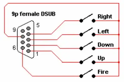

A first starting point for such a project might be looking at the wiring of a joystick:
It shows that a C64 Joystick works by connecting either port pin to to ground. If that connection is not made, then all input will read high value - as you already found out. This is due the fact that the 6526 already contains internal pull up resistors, making sure that non grounded pins will deliver a steady high signal.
Essentially this means outputting a LOW from the Arduino would make the value for that button (pin) go zero. Except, to do so, they need to agree what low means, as each device low is independent - unless they use a common ground, like with connecting the ports pin 8 (GND) to whatever it is on the Arduino side.
