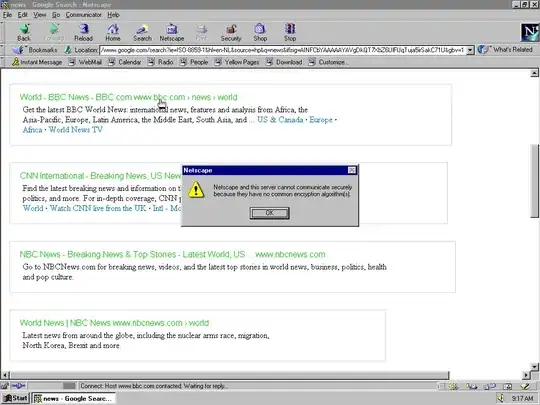

I'm having trouble accessing HTTPS websites using Netscape Communicator 4.8. This is the error message I get:
Netscape and this server cannot communicate securely because they have no common encryption algorithm(s)
Is there a way I can configure some sort of proxy that will allow me to access HTTPS websites over HTTP? Or any other solution to this problem?

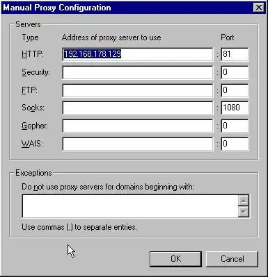

Then, on the Window 95 machine, I opened Netscape Communicator and went to Edit -> Preferences -> Advanced -> Proxies -> Manual Proxy Configuration and entered the following information:
servers: HTTP: Address of proxy server to use: 192.168.178.129 Port: 81
(Note that 192.168.178.129 is the IP address of the machine that is running nginx in my case.)
