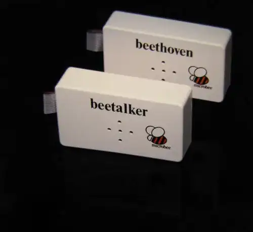

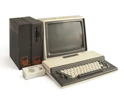

For the 1980's Microbee (z80) there was a hardware module named "Bee Talker" which plugged into a parallel port. It looks nearly exactly like the "Beethoven" unit in this image (seen sitting next to the "keyboard"), except it was labelled "Beetalker":
It had a simple Text-to-Speech software interface that came with the module. Whatever you typed in the console would be somewhat weirdly converted to speech. I don't remember exactly what worked well, but sometimes you had to phonetically misspell the word to get the desired result.
The module has been re-released should you want to connect it to an Arduino or whatever.
EDIT: Finally found a better image:
- 353
- 2
- 9
2Thanks! Looks like this is based on the very popular SP0256-AL2 chip from the 1980s. It's good they've released it in a dual MicroBee/Arduino compatible module this time round – scruss Dec 09 '20 at 02:40
