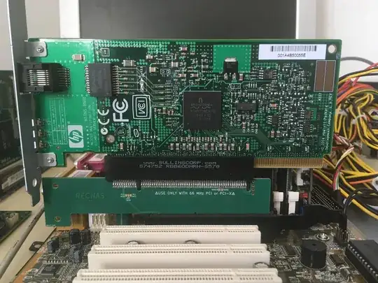

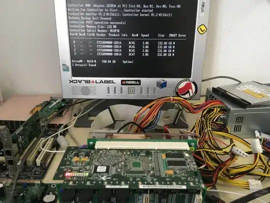

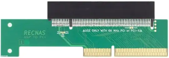

While working on upgrading my Super Socket 7 based NAS, trying to get as much performance out of the platform as possible, I asked myself the same question. As an obviously headless NAS won't need a graphics card sitting in the AGP, why leave the interface with the highest throughput unused? And I started researching into the AGP port. When looking for information online about using the AGP port for anything else than a graphics card you won't find much. So I had to look for information elsewhere. And I found some in the AGP Wikipedia article:
An AGP bus is a superset of a 66 MHz conventional PCI bus and, immediately after reset, follows the same protocol.
And further reading of the AGP spec reveals the same thing, almost all the PCI signals are part of the AGP connector. So making an AGP to PCI adapter seemed pretty straight forward. But it really looks like nobody has done it, at least there's no evidence to be found. So I began to tackle it myself. I usually prefer to build prototypes before designing and ordering PCBs so I also chose to try the manual way first in this case. PCI and AGP riser cards were quickly sourced and as soon as I got them the port of the AGP riser was ripped off and wired straight to the PCI riser according to the AGP and PCI specs. Handbuilt AGP to PCI Adapter After finishing the adapter I noticed that I didn’t have a PCI graphics card at hand and I therefore had to test it blindfolded. So I plugged in an HP NC370T PCI-X Gigabit Ethernet card into the AGP port of my testbed, fired it up and tried to SSH into it. And it worked. Just like that. I still can’t really excite myself about it, as it was just too easy. Usually stuff like that never works on the first try. After the handbuilt prototype proved that an adapter of this kind is working I started to design a PCB according the AGP spec for impedance and length matching. Final AGP to PCI Adapter So far any network card I’ve tried worked flawlessly. Compatibility with PCI-X hardware RAID cards seems to be more problematic, although a simple SiI 3512 based SATA adapter works flawlessly. My assumption currently is, that hardware RAID cards rely on the LOCK signal, which is missing from the AGP, for cached writes. So cached writes are either disabled (Adaptec 2420SA), crash the system (3ware 9550), or the RAID set isn't recognized at all (Areca). Adaptec 2820SA connected to AGP (Bus:01) But if the connected card and the underlying system have the capabilities the full 32bit 66 MHz PCI bandwidth of ~250 MB/s can be achieved.
As I've got a couple of the PCBs made, I've setup a simple ordering page for the adapter and other retro hardware related stuff I'm working on: https://recnas.org/
RECNAS AGP to PCI Adapter

    Amazing work. I wonder if it can count as an answer if you created it as part of answering the question? ;-) – Jacob Krall Jul 04 '22 at 20:22
    @JacobKrall No reason why not. The exception is something like Code Golf where it is a contest and that would be cheating (it is spelled out in the rules). But in most other SE sites, including RC, the goal is to solve problems, and creating something new is perfectly fine. – manassehkatz-Moving 2 Codidact Jul 10 '22 at 18:45

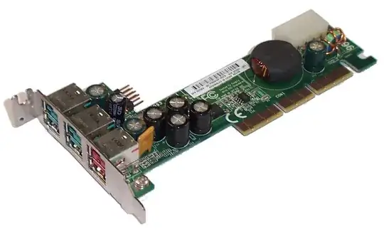

No, there was an AGP to USB card.
The HP rp5000 Point of Sale system was launched circa August 2003 and includes this unique AGP card: HP r5000 AGP to PoweredUSB card

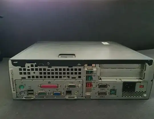

The rp5000 has the (half-height) AGP card installed vertically and two PCI slots installed horizontally using a riser board, allowing the use of two full-length PCI cards on a half-height system. The AGP card is placed flush with the rest of the motherboard I/O, slightly disguising it.
Back I/O of HP rp5000

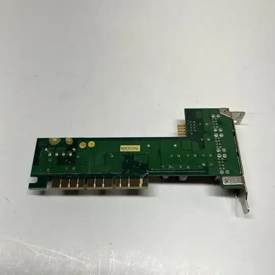

This card provides three PoweredUSB ports used to connect and power barcode scanners and receipt printers for a POS setup. The two blue ports provide 12V power and the red port provides 24V power (power provided via Molex connector). The nine pin internal USB connector on the top of the card connects the 12V ports to the motherboard's internal USB header with an internal USB cable. However, as can be seen on the back of the card, pin 4 of the card traces towards the 24V port, meaning the card is using the USB connection provided by pin 4 of the AGP spec, as linked above, to connect that port. Pin 1 side B of the AGP port provides USB overcurrent protection, but it is left unwired, as PoweredUSB has its own OCP. The rest of the AGP pins are also left unwired except the ground pins, and there's reason to believe the AGP port on the motherboard is also not fully wired, as the rp5000's hardware reference guide states "An AGP card will not work in the AGP slot."
Backside of the card, showing pin 4 connected and tracing towards the bottom USB port
So why use AGP if the only thing you're using from the standard is the USB connection for only one USB port? A later model from the line, the HP r5700, used a PCI card for their PoweredUSB ports instead, so a half-height PCI card could have been used instead.
The only reason I can think of is that there must have been only four USB ports available from the motherboard's USB controller, as the rp5000's motherboard has two USB ports on the motherboard I/O and one internal USB header for the two 12V ports. Given this limitation, HP had to create a card that would also provide USB support to a fifth port. HP could have done this using PCI, but that would require purchasing another USB controller chip, so they decided to use the single USB port provided by the AGP standard instead.
In fact, the rp5700 PCI card didn't use the PCI interface with a USB controller to connect its USB ports either, as all its data pins are left unwired. Instead, it uses internal USB connectors for its four ports, but its motherboard supports two internal USB headers.
This is a super unique use of the AGP port, and the only other devices that I know of that actually use the USB connection are the Apple-specific versions of ATi and Nvidia AGP video cards that supported the Apple Display Connector.

    Looks like a 3.3V AGP-Pro card. Nice idea and for sure a good way to add much needed ports to a POS system while still keeping both standard slots available for customer specific add on. Nice find. Thanks. – Raffzahn Nov 17 '23 at 15:43
