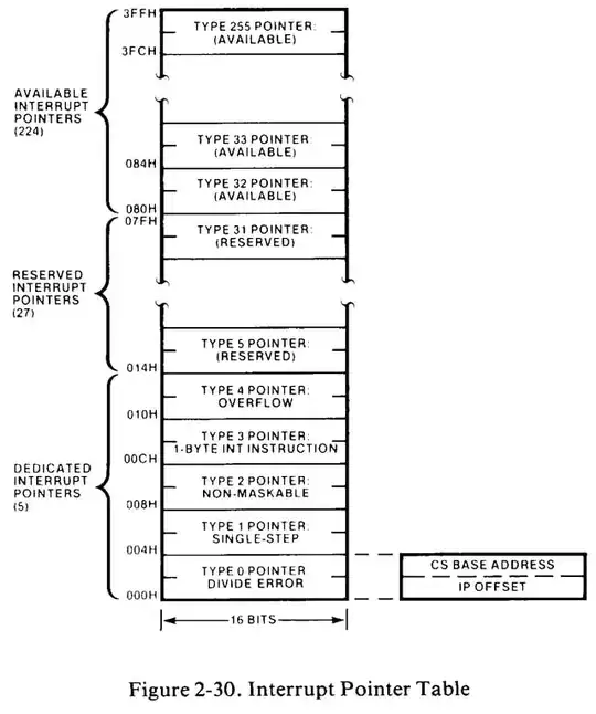

The original 8088 only defined exceptions for the first 5 interrupt vectors, for Divide Error, Single Step, NMI, Breakpoint, and Overflow respectively. Interrupts vectors 5 through 31 were marked as reserved in Intel's 8086 Family User's Manual:
8086 Interrupt Pointer Table
Despite this, IBM decided to have their BIOS configure the interrupt controller to deliver hardware interrupts starting at interrupt vector 8. Since the original IBM PC only supported 8 hardware interrupts, this meant that vectors 8 through 15 were used for hardware interrupts. IBM then started assigning BIOS services starting with vector 16 (10h), to be invoked using software interrupts. In addition, vector 5 was used to implement a print screen function. Reserved vectors 6 and 7 weren't used.
