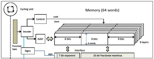

The Zeus Z1, Zeus Z2, and Zeus Z4 used "mechanical slotted metal strip memory". These were not stored program computers where the program is executed entirely out of main memory; rather, then program was read from a punched tape reader (Z1 and Z4) or punched card reader (Z2). The memory was used primarily for data, but it was randomly addressed.
The first clue that Z1 memory was randomly addressed is seen in this block diagram from The Z1: Architecture and Algorithms of Konrad Zuse’s First Computer, p. 4:

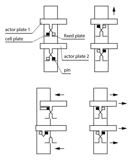

This illustration from p. 11 shows the working of a memory bit:
Figure 9: One mechanical bit in the memory. The pin can be stored in the zero or one position. Its position can be read.
Diagram 9(a) shows two stored bits. In step 9(b), a control plate moves the pins up. In step 9(c) the horizontal actuated plate is pusehd (lower bit) or not (upper bit) by the stored bit and the clocked plate. In step 9(d) the bits are moved back to their original position, where the vertical control plate can bring them to position 9(a). Reading a bit from this type of memory was a destructive process. After reading a bit, the contents of the bit cell had to be restored by the movement back shown in 9(d).
