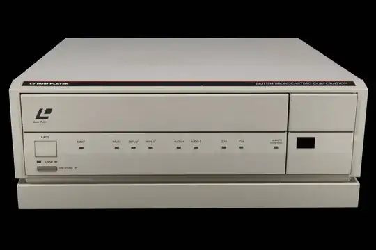

In the movie Licence to Kill, James Bond breaks into Felix Leiter's house and gets a CD out from behind a picture. He then sticks a CD in an absolutely massive CD drive. It was about three times the width of the CD. This movie was released in 1989. I've never seen anything like that before. Did such CD drives actually exist?

As far as I remember, this wasn't a CD, but (supposed to be) a Laserdisc, and he was using a Philips player (the movie contained several Philips machines). Laserdiscs were available in different sizes between 12 cm, which is like a CD and up to 30 cm (LP size).
In a technical way, the movie screwed up, as Laserdisks were neither digital (they used an analogue format) nor writable. Except for the LV-ROM which could carry digital data as well - still not writable.
Looking at this picture from Starringthecomputer,
Enter image description here
it seems plausible that it is a Philips VP-415:
(The same drive was used for the Acorn/BBC Domesday Project.)

    @tofro Erm (re-) watch the film. Story goes that Felix had stored (written) sensible data onto the disk, prior to his death, and Bond retrieves it later on, using the Philips setup. There is no dispute about copyright or alike involved. It has simply screwed up by using the wrong props - maybe in part because the CD-R was only finished a few month after filming had started. – Raffzahn Aug 23 '20 at 12:28

    Might be worth mentioning there were writable Magneto-Optical discs that size in existence when this was filmed. The LV ROM player depicted is not that, and MO discs are generally contained inside a caddy, not a bare disc. But the concept of a big writable disc itself isn't far-fetched, they just got the details wrong. – mnem Aug 23 '20 at 16:04
  • @mnem The disk used was smaller. More like a CD. And most definitely not a MO. – Raffzahn Aug 23 '20 at 16:25

That is a Philips VP415 LV-ROM player.
