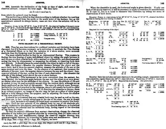

36
Every ship at sea carried such a human computer, in the person of the navigator. He followed a number of such "programs", properly termed algorithms, taken from Nathaniel Bowditch's seminal work The [American] Practical Navigator. Here is a two-page spread from a 1940 edition of that work:
Bowditch
This is a worksheet, containing labelled spaces as an aid to correctly performing each algorithm, rather than a complete description of the algorithms themselves. The navigator would prepare copies of this worksheet in advance of need, rather than writing in the book itself, and would be familiar enough with the algorithm to be able to follow it using only the worksheet and the various lookup tables that it referenced. Here is part of one such lookup table:
Trigonometry
For an actual algorithm we must look earlier in the book; this describes not only the mathematical operations required, but also the means of taking measurements upon which the calculations are based:
