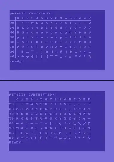

The downside is that graphic symbols are encoded according to the (unsifted) character code. And here combinations like UIJK are simply non-continuous. As listing the PETSCII assignment shows:
(Taken from Wikipedia)
From a programmers perspective this is less than perfect. A logical sequence for related items (*3) could have been more helpful. This is especially true for the 16 codes that form a 2x2 division of a character cell would allow an easy 'bitmap' mode for 80x48 pixel (*4). Much like contemporary TRS-80 and Sinclair's ZX80/81 some years later.
An additionally sad part is that PETSCII itself isn't direct used for display, but translated into screencodes beforehand. If not right ahead, this would have been a good point to reorder.

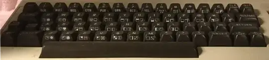

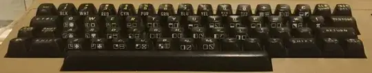

For what it's worth, I did a quick photo of my C-64 and VIC-20 keyboards, so it's very easy to see the physical grouping of the various graphics/symbols.
Commodore C-64 Keyboard:
Commodore VIC-20 Keyboard:

    The VIC20/C64 keyboardadd another layer of complexity as the number of keys got reduced from the PET design, so their symbols had to be shuffeled as well ... in addition the keyboard was made to work like a traditional one, taking away the shifted position from everything but letters and a few extra keys. – Raffzahn Jul 23 '20 at 12:34
  • Which appears to be same as my C128D, which I should probably clean up... – PTwr Jul 23 '20 at 15:27
