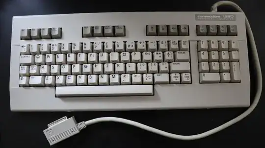

Of the variants produced in a relatively large series - let me remind you about the keyboard connection on the Commodore 128D - it was connected using a 25-pin interface, 23 lines of which directly represented the matrix of keys. enter image description here

    Do you have a pinout for the connector? 23 lines for the matrix? That makes no sense. Theoretically could be as few as 7 (for up to 128 keys). Practically, 3 for row (up to 8 rows, and there are only 6 rows including the lone spacebar) and 5 for column (up to 32 columns, far more than this keyboard) = 8 pins. So 23 is either an incredibly inefficient layout or includes other stuff - alternating ground pins? feedback of some sort? – manassehkatz-Moving 2 Codidact Jul 16 '20 at 14:06
    @manassehkatz-Moving2Codidact There's no logic in the keyboard, not even an encoder / decoder :-). It's an 8x11 matrix (= 19 pins), plus three extra pins for the locking 40/80 and caps lock keys and restore (giving 22 pins), plus GND, plus 2x N/C. That's it. – Michael Graf Jul 16 '20 at 14:51
    Very similar to the Wang minicomputer technology. Judging by the picture, Commodore was able to achieve a thinner and presumably more flexible cable than Wang Labs did. – A. I. Breveleri Jul 16 '20 at 15:01
    @manassehkatz-Moving2Codidact There's a pin-out at http://oldcomputer.info/8bit/c128/51.gif – Callie J Jul 16 '20 at 18:51
  • Looks similar to the 23-pin D-connector they used in the SX-64 – scruss Jul 17 '20 at 01:08
  • Except, it's not a parallel keyboard, but a simple Matrix. The C64/128 does not use a decoder, but two ports active scanned by the CPU. – Raffzahn Jul 17 '20 at 11:08
  • @manassehkatz-Moving2Codidact, perhaps a differential signal? That by it's nature doubles the needed lines. – tgm1024--Monica was mistreated Jul 18 '20 at 22:42
