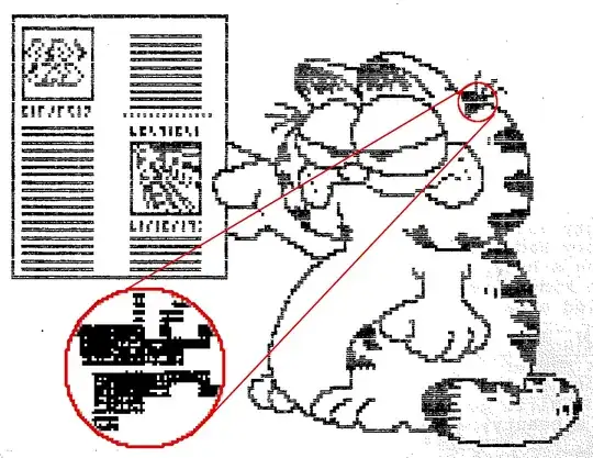

Reading this was a huge a-ha moment for me, as I finally understood why the cheap Epson-compatible printer I used in the 1980s (a Smith-Corona Fastext 80) always left horizontal gaps at regular intervals when printing graphics. It annoyed me to no end that all the solid areas and lines in the images I printed got broken up like this! Below is an example of what I'm talking about—this is a scan of a real graphic that I produced using Doodle on my Commodore 64 in 1987. (I copped the Garfield cartoon from somewhere but added the journal he's holding to promote our class newspaper.) Unfortunately the scan isn't of great quality (and is of a photocopied image rather than the original printout) but you can make out the gaps in some places, and particularly in the area I've highlighted and magnified.
A scan of a printout from a Smith-Corona Fastext 80 showing a cartoon image of Garfield the cat holding a newspaper. The solid black lines making up the image are broken at regular intervals by white horizontal gaps.
So I assume now that these horizontal gaps are a result of the printer using only the top 8 of its 9 pins, but advancing the paper roll the height of the full 9 pins after every printed line.
My question is this: Why did the Epson MX-80 and its descendants not use the full 9 pins to print graphics? Was there some technical reason why this was not possible or desirable? (And were any of those printers smart enough to advance the paper roll by the height of 8 pins rather than 9 when printing graphics, thus avoiding those ugly gaps?)

    I’m not posting an answer because that’s NOT what you asked, but your premise might be a bit off. I owned that particular printer (my first!) and it had some odd quirks. For example I think it could not do a Carriage Return without advancing the feed at least one pin down, likely a mechanical limitation (this has to be documented in the manual because I had no other source of information and I’m pretty sure I know about it, vs. deducing it). That could and would mess with software and result in banding depending on how the printing routine worked. I don’t remember all the details. – Euro Micelli Jun 10 '20 at 17:04
    The Fastext 80 also had a tiny buffer and could not print a whole line of graphics in one shot. If you wanted to cover the whole page horizontally the software had to issue multiple, consecutive graphical commands for each line, with each one not exceeding the limit (maybe 200 bytes? I don’t remember; it’s been 35 years). The head would stop and reset back a bit (I presume to give the head enough time to reach the prescribed speed) before printing the next block. It took four (was it five?) blocks to cover the width of the page – Euro Micelli Jun 10 '20 at 18:24
    The Fastext 80 would also overheat after printing 1/3 page of 100% black block graphics. Or 1/2 page of 100% black bitmap graphics. I suspect the reason that it could print more in bitmap mode was that bitmap mode was much slower (due to the interfaces being slow, and also due to the extraneous head movements mentioned by Euro Micelli; I guess the buffer size was 80 bytes), so it would build up heat at a slower rate. – Klaws Jun 12 '20 at 07:36
  • Probably it was only the screen dump software that should have been dumped (sic). You could easily adjust the line spacing to only advance the paper by 8 dots instead of 9 before entering graphics mode. The MX-80 had commands for this. – tofro Oct 06 '20 at 11:56
Right... err ... at least basically.
If that was the reason, and if it was constant, it's most likely not the fault of the printer, but a wrong command to advance the paper (ESC+A).
But looking at the picture included, the gaps seam to be less than a pixel height. So it may not have been a wrong command, but simply less than desirable mechanics, always leaving a little gap. This is known from many printers, including genuine Epson MX-80. It doesn't make a big difference for text (especially if always about the same), but comes up in graphics.
These 'modulations' were simply part of bitmap graphics around 1980. Although, printers did advance (*1)

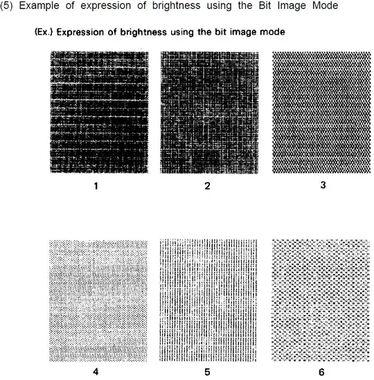

Already the original MX-80 (Type 1) could set the paper advancement in steps of 1/72 inch, essentially to each needle height. Its mechanics operated in 1/216 inch steps. The Type II inherited this. But here as well, advancement was less than perfect, leaving artifacts. They are even visible in the original Epson manual printing:
Fill examples from Epson MX-80 Type II Manual
(Taken from Epson MX-80 Type II Manual p.83)
Long story short: Don't expect a 1965 VW-Beatle show features and performance of a luxury car (or in looking back the one of a 1990 VW Golf)
You could have bought a way more expensive printer, or waited 5-8 years for consumer products growing in quality ... or do like you (and we all) did, proudly show the results and live with these tiny, negligible artefacts.
