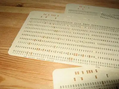

I thought that punched cards already represent the code in binary since a hole means 0 and rest positions mean 1 on a punched card. But then I read that you could use punched cards to present the Cobol or Fortran codes. I also noticed that there are always 2 holes per column on a punched card. Such things have confused me.
Were the punched cards really binaries, or some sort of assemblers were needed to convert the input provided by punched cards to machine code?
I am particularly interested in knowing the oldest way of providing input to computers using punched-cards.
Cards with 'fewer' holes are likely cards that are to be considered as text. There is one character punched per column, with each character encoded as 0 to 3 holes. No holes is a space. Roughly speaking, the code space is laid out like this: the digits are encoded as one hole, in rows 0 to 9 with the obvious meaning. Letters are encoded as two holes, one of which is in row 11, 12, or 0, and the other in 1 through 9. Other 'special' characters need 3 holes. You can see the encoding on this page a little way down.

The earliest use of punched cards for computing was not in what you'd nowadays call a computer, but in Hollerith tabulators and similar machines, which were the 1930s state of the art for business and scientific calculation. They would be set to perform a particular operation, such as summing all the cards that were fed into them, or multiplying the values on one deck of card by those on another; then you had to set them up again for a different operation. Some other early machines used punched paper tape, then primarily used in the telegraph industry.
The first computers did not have an assembly language. Instead you got an operator's manual which informed you about how to punch the card or tape to produce a given operation from the machine. So you entered machine code directly, after perhaps working it out using mnemonic code on paper, by hand. Assembly language was eventually developed so that you could just enter the mnemonics, and let the machine itself take care of the translation to machine code. Of course the machine code would vary between machines, often by a lot.
The particular cards shown in the question have rows numbered from 0 to 9. This indicates they contain decimal numeric data. One of the two punches in each column is a numeric, and the other is probably a parity bit. This suggests to me that they are cards for a Hollerith machine, not a computer.

    While the cards don't have the zone punch rows 11 and 12 (at the top) marked, they are punched, which suggests to me that they're likely not just decimal data. I've never heard of cards using a parity bit for each column. – cjs Mar 10 '20 at 16:06
  • @cjs, "marked?" Ink on the card means nothing to the computer. The computer (or other data processing equipment) only cares whether or not there's a hole that light can shine through (high-speed reader) or metal fingers can feel through (old-school tech.) But, if you're talking about the cards in the photograph, then yes, those look like they represent text. If you were willing to spend a little time, you probably could decipher the one on the top of the pile. – Solomon Slow Mar 11 '20 at 19:56
  • @SolomonSlow Yes, exactly my point! (Read my comment in light of the last paragraph of the answer.) – cjs Mar 12 '20 at 05:12
  • @cjs. Mmm, Yes, I see. FBO Chromatix: If you look at it from a business applications point of view instead of a computer science point of view, then the progression from Hollerith's first tabulating machine to IBM's System 370 was a long sequence of many small improvements. There never was any bright dividing line between the computer age and what was before. [B.T.W., That picture of cards on a desktop almost could have been my desk, back in the 1970s. Only difference being, the cards on my desk probably would have been interpreted (i.e., row of human-readable print across the top edge.)] – Solomon Slow Mar 12 '20 at 13:52
