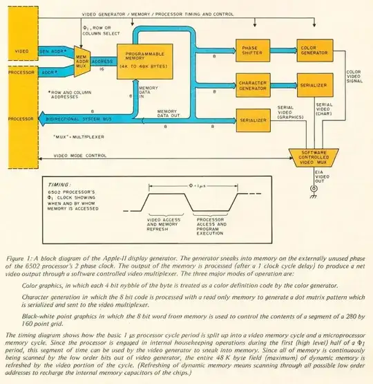

Apple II display generator block diagram
The video system, during its cycles, simply walks through each address in the screen memory, reading it and then using that data to generate part of the scan line on the video monitor or TV. And now you see why the Apple II uses the rows, and not the columns, for the low-order address bits: this means that the video system will be looping through every row in each DRAM in every bank, asserting RAS, as the preparation for asserting CAS in the bank from which it's reading the screen information. This loop happens fast enough that, as a side effect, it refreshes all the RAM in the system.
Since this all happens during Φ1, when the CPU is off the bus, the CPU neither knows nor cares that this is happening. Thus it's often called "transparent refresh."
