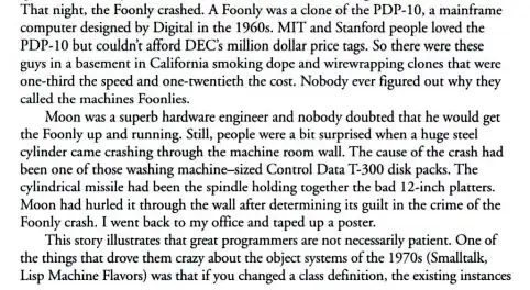

There is also this tale that I read recounted in Philip and Alex's Guide to Web Publishing, although the disk pack was intentionally hurled through the wall in a fit of temper:
Excerpt from Philip and Alex's Guide to Web Publishing article
That night, the Foonly crashed. A Foonly was a clone of the PDP-10, a mainframe computer designed by Digital in the 1960s. MIT and Stanford people loved the PDP-10 but couldn't afford DEC's million dollar price tags. So there were these guys in a basement in California smoking dope and wirewrapping clones that were one-third the speed and one-twentieth the cost. Nobody every figured out why they called the machines Foonlies.
Moon was a superb hardware engineer and nobody doubted that he would get the Foonly up and running. Still, people were a bit surprised when a huge steel cylinder came crashing through the machine room wall. The cause of the crash had been one of those washing machine-sized Control Data T-300 disk packs. The cylindrical missile had been the spindle holding together the bad 12-inch platters. Moon had hurled it through the wall after determining its guilt in the crime of the Foonly crash. I went back to my office and taped up a poster.
This story illustrates that great programmers are not necessarily patient. One of the things that drove them crazy about the object systems of the 1970s (Smalltalk, Lisp Machine Flavors) was that if you changed a class definition, the existing instances
    Wow, that's the first actual reference to a similar-sounding event! Its plausible to believe that this original story got modified in retelling to become a hardware accident vs. a frustrated programmer. – StayOnTarget Feb 17 '20 at 17:56

    Oh dammit, what did existing instances do, if you changed the class definition??! – Gnudiff Feb 17 '20 at 21:10
    My hardcopy of the book is long buried under other volumes. I imagine they had to be reloaded or reinstantiated somehow from the new definition. – Samper Williams III Feb 17 '20 at 21:14
    @Gnudiff "...if you changed a class definition, the existing instances of that class did not get modified. You'd have to restart your program, maybe even reboot your computer, if you changed your mind about how to represent something. You could lose 20 minutes or even more." ref.: https://philip.greenspun.com/wtr/dead-trees/53011.htm – OnoSendai Feb 17 '20 at 23:52
  • @Gnudiff you're surely welcome, and the rest of the book is actually quite interesting as well! – OnoSendai Feb 18 '20 at 18:21
  • I have no way of knowing if this was THE story which was retold in my lecture, but its the only published source anyone has come up with which at least probably invalidates the purely "apocryphal" speculation. – StayOnTarget Feb 19 '20 at 12:16
  • "...the existing instances of that class did not get modified." - No big deal to a for loop. – Cees Timmerman Feb 19 '20 at 16:15

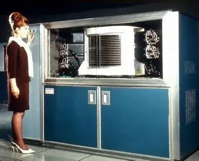

This is the disc store from a 1965 KDF9:
KDF9 disc, from 1965
If a read/write head contacts the spinning disk, it could (I suppose) get ripped off the actuator arm, and thus be accelerated to the extent that it penetrates the glass on the door and causes mayhem in the machine room.

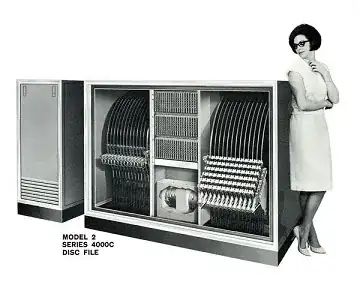

This Bryant device looks much more likely to cause mayhem if the disks ever got loose, due to the vertical mounting of the huge platters.
Bryant large disk drive

    I imagine you also have a higher chance of flinging disks around if engineers are tinkering with the mechanics. – user253751 Feb 17 '20 at 11:20
    I've seen disks that have been subjected to a head crash (in fact I've got a platter that that happened to). Typically the head gouges a groove in the disk rather than gets detached from the actuator arm. – JeremyP Feb 17 '20 at 11:57
    A gouged disk platter was a popular wall decoration in any self-respecting software development office back in the 1970s :-) but I never bothered to ask the details of what happened to the drive, beyond knowing that surgery was typically needed. – dave Feb 17 '20 at 12:08
    Goldfinger: "And this is the disc store from a 1965 KDF9." Bond: "Do you expect me to talk?" Goldfinger: "No, Mr Bond, I expect you to die! There's nothing you can talk to me about that I don't already know!" – David Tonhofer Feb 18 '20 at 14:23
    The lady in the second photo seems to be more aware of the risks, is standing to the side and wearing safety goggles. – Transistor Feb 18 '20 at 21:42
  • @Transistor the goggles, they do nothing against a fast spinning disc of solid metal 1m in diameter. I would wager a guess it's nothing more than a fashion or fashion/medical accessory. – John Dvorak Feb 19 '20 at 09:51
  • @JohnDvorak - I would wager a guess that Transistor was intentionally making a joke about her mid-1960s glasses. – dave Feb 19 '20 at 12:34
    @JohnDvorak: She's standing out of the disks' plane of rotation, so all she needs to worry about is bits of detached, deflected shrapnel (which are much easier to shield against). – Vikki Feb 19 '20 at 23:04
    @Sean shrapnel versus the entire disc is an excellent point. I'll give this one to you. – John Dvorak Feb 19 '20 at 23:39

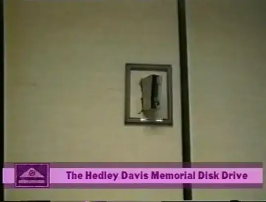

I couldn't resist posting this image taken from "The Commodore Deathbed Vigil" (at the approximate 9:43 mark; 11:00ish in YouTube linked below).
For those interested, I pulled this image from my copy of Cloanto's Amiga Forever DVD, but Dave Haynie also has the full video posted on his YouTube channel here.
The Hedley Davis Memorial Disk Drive
