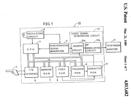

Here's an image from Nintendo's Video target control and sensing circuit for photosensitive gun patent on how the hardware works:
More images on the entire process flow are also available in that patent link.
