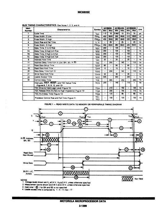

However, 6809 requires rather strange two-phase clock (see here, page 3, that consists of two square waves shifted by 90 degree. Actually, MC6809 generates those phases internally from x4 XTAL, but MC6809E, lacking XTAL generator, requires such phases as the input, so it could be thought as the internal requirement. example of 6809 and 6809E two-phase clock
In what ways such shifted two-phase clocks are used inside the 6809? Are there any other designs with similar clock requirements? Are there any papers introducing this type of clocking?

E is used for memory selection in a similar way as 6502 do (or 6800 phi2). Q should be used as a signal "data stable" (due to "The MC6809 Cookbook"). Let me quote:
Addresses from the MPU will be valid with the leading edge of Q. Data is latched on the falling edge of E.
It is called the "quadrature clock" and it is used sometimes in other systems too.

  • MC6809E datasheet ( http://www.colorcomputerarchive.com/coco/Documents/Datasheets/MC6809E%20HMOS%208%20Bit%20Microprocessor%20(Motorola).pdf ) states, that E drives internal circuitry directly (it does require non-TTL levels), while Q has ttl levels (nothing is said about what it drives). – lvd Jan 22 '20 at 16:27
