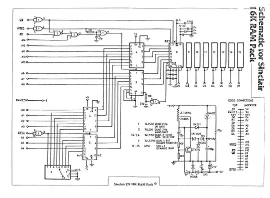

    A comment since it's partly speculation rather than something I know for certain: The ZX80 and ZX81's edge connectors are more or less identical, and the ZX81's 16K RAM pack contains a DC-DC converter circuit to generate -5V from the +9V supply on the edge connector: http://www.retroisle.com/sinclair/zx81/Technical/Hardware/16KRamPackSchematics.php - look at the analogue circuitry in the bottom-right. It seems likely that the ZX80 RAM pack would have the same or similar design. – pndc Dec 28 '19 at 11:32

Right, and the 'missing' voltages (-5V,+12V) get generated from the +9V source via a discrete DC-DC converter - that's all the little pieces on the second board.
The difference between the RAM-Packs for ZX80/81 is all in the colour :) In fact, for a short time, the new (black) packs were delivered using the old boxes.
ZX80 and ZX81 are basically the same machine. Their board connectors differ only in pin 23: not connected on the ZX80, but /ROMCS on a ZX81. This was done to simplify ROM updates.
As the schematic shows, the RAM-Pack doesn't use /ROMCS in any way. All it uses are data lines, address lines (to be multiplexed) and associated control signals.
ZX RAM-Pack Schematics
The power circuit, shown in the lower right corner, takes the +9V (supplied on lower side second pin) and turns it into -5V and +12V. The +12V tap is a bit hard to find as it's hidden within, below the rightmost 22 µF capacitor.

  • I'm a bit surprised that there is a refresh counter on this board, given that the Z80 itself issues refresh cycles. What is the reason for the counter? – Andreas Krey Dec 28 '19 at 20:42
    @AndreasKrey ZX80/81 video uses the refresh counter to count characters within a line, thus it's not running thru all needed values. As a result, the DRAM did need it's own refresh counter. After all, the /RFSH signal can still used to control the cycle. – Raffzahn Dec 28 '19 at 22:00
    @Tommy already wrote some information in another answer - including good links to details about how ZX80/81 video works. Maybe open a related question, so he can add details missing. – Raffzahn Dec 28 '19 at 22:24
