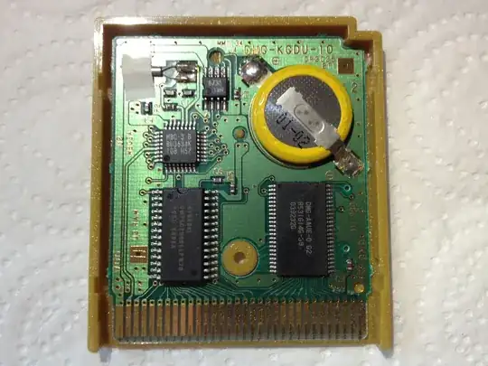

Gameboy games use a CR2025 battery which over the years eventually dies stopping games from saving and causing previously saved games to disappear. Note however while the game is powered you can still save, however once you power down the save will be gone.
Original battery

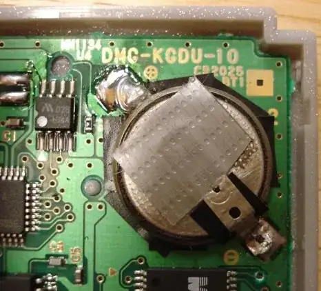

In order to replace the battery you must open up the cartridge with a 3.8mm screwdriver security bit. Next you have to carefully pry the connectors loose from the existing battery since the original battery is actually soldered to the connectors. A common method on replacing the battery is to use an adhesive (preferably) electrical tape to hold the new battery in place. It's important to note you do not want to remove or break the current connectors, if you do so you will need to buy a complete kit which requires you to solder new connectors in place.
Replaced Battery
Once replaced you can continue to save games again, however down the road in 10-20 years you will have to replace the battery again.

    Tape seems a bit unreliable. I would get a battery with leads pre-attached (easily obtained from digikey or ebay) and solder new leads in. Or even look at soldering in a low-profile battery holder, as that would make future replacements very easy. The battery, incidentally, is not soldered to the connectors; soldering to a battery is a very bad idea as it requires heating the battery well beyond the point of damage. Instead, it's tack-welded; you can get a machine for tack-welding batteries for a few hundred bucks, but for this application I would just get a battery with leads already on. – Hearth Sep 11 '22 at 17:52
  • @Hearth I agree actually, have done it quite a few times in the last few years.. keep in mind this answer is from 2016, I can't recall if they were doing preattached leads at that time. However I should probably update the answer. – Loktar Sep 11 '22 at 18:54
    @Loktar They were; I've repaired a few gameboy and NES games this way going back several years. The tape method is probably the best option if you aren't comfortable using a soldering iron, though (although a soldering iron is really not difficult to use, not for something like this. As much as I hate them, you could probably do this with a $5 hardware store iron.) – Hearth Sep 11 '22 at 19:20
