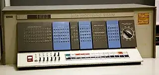

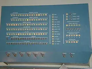

In the 1950s either push buttons, such as on the IBM 1620, or momentary-contact toggle switches (that spring back to "off" when released), such as on the PDP-1, were used, depending on the manufacturer and model:
IBM 6120 front panel PDP-1 front panel

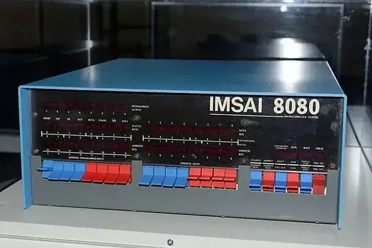

IMSAI 8080 front panel
(Above, the left-hand two banks of eight switches are standard ON-OFF toggle switches for address and data input. All of the right-hand bank of six switches, except for the right-most POWER switch, are two-way (ON)-OFF-(ON) momentary toggle switches for functions like EXAMINE, EXAMINE NEXT, DEPOSIT, RESET, etc.)
In at least the case of the Altair 8800 and the IMSAI 8080, these momentary contact toggles were still (mostly two-way) SPST switches, no different electricially from normally-open push buttons.¹

There were also likely design decisions. If you look at the IMSAI 8080 front panel, the on-off and momentary contact switches are similarly designed.
