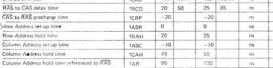

However, in the Mostek 4116 DRAM datasheet, Column Address Set-up Time, a.k.a t_ASC, the time between a valid column address and the falling edge of /CAS, is a negative number. In other words, /CAS is allowed to start falling even before the column address is stable, up to 10 nanoseconds.

I know a negative set-up time is sometimes used in digital devices, but what is the specific design rationale of having a negative Column Address Set-up Time in 4116 DRAMs? Is it simply a side-effect (e.g. propagation delay?) of the logic details used in 4116? Is it designed to allow the timing requirement to be met more easily? A faster access speed? Or it's something else?

    My slightly educated guess would be that as a result of its internal design, the 4116 definitely won't get around to "sampling" the column address for at least 10ns after /CAS is pulled low. With this "promise" in mind, a designer is free (as you say the TMS9918 does) to pull /CAS low slightly before the column address has stabilised, if that is easier/makes more sense. – TripeHound Jun 12 '19 at 08:13
The 4116 was likely designed during in an era (or semiconductor technology node) when self-timed-delay pre-charge-evaluate NMOS logic cascades were common. (e.g. rather than synchronously or edge clocked CMOS)
The bit-line sense amps and wide column select mux had to consist of a large total gate area. Thus it would take quite awhile to precharge all of that. The column address would not be needed to pull down some selected gate path until after the precharge completed, This might take up most or all of that 20 nS using NMOS transistors that were several square microns in gate area. The column address thus need not be latched until after the end of the precharge pulse that was perhaps triggered by the falling edge of CAS.

  • Great answer. I figured the implementation was something along the lines of what you suggested, but you have made it quite clear. My answer only addressed why such a feature might be useful. – Zane Kaminski Jun 18 '19 at 06:59
I will venture a guess.
Imagine /CAS and the address bus are both registered outputs clocked by the same clock. The negative setup time allows a slight clock-to-output propagation delay discrepancy between the two outputs where /CAS falling may precede the address bits becoming stable.
Moreover, there are other factors which may add propagation delay to the address bus compared to the /CAS signal. The address bus could drive many more DRAM chips than are driven by the /CAS signal. There could be multiple banks of DRAM sharing the same address bus but separate /CAS signals. Or for example a 16-bit DRAM system which allows writing to either one or both of the bytes of a 16-bit word. Such a system would likely have separate /CAS lines for each 8-bit half of the 16-bit width, but the address bus can be shared among all of the DRAM chips. Or maybe the address bus is buffered, and the negative setup time allows a bit more buffer delay for the address.

(Preface: leaving out the title column makes reading tables it a bit hard)
It's all about translating labels and numbers into meaningful sentences. And there are different ways to tell a fact, and thus more nuanced details.
Timing does describe relations. Here it's about the fact, that CAS must be released at least 20 ns before RAS can be pulled again. It's the relation between these two.
Of course it could also have been described as RAS can be pulled at earliest 40 ns before CAS can be pulled, but that sounds optional.
Or translated as English sentences:
tCRP -20ns means:
"A following access indicated by RAS must allow for at least 20ns after the rising edge of CAS."
while tCRP 5nssays:
"A following access indicated by RAS may happen at least 20ns after the rising edge of CAS."
The message is the same, comes down to the story the designer wants to tell.
