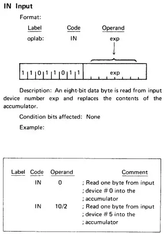

The port number can take 256 possible operands. Apparently d8 means an 8-bit operand.
From the 8080 Assembly Programming Manual
The OUT instruction has a similar description.
Seeing this line
IN d8 ; only index 0-7?
in some actual source code could mean that the particular hardware the program runs on implements (decodes) only the three least significant address bits, writing to a port address greater than 7 would wrap around to the [0..7] range, do weird things, or simply be ignored.
