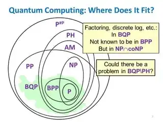

Extremely powerful! Having direct state access to the state vectors would be equivalent to having a black box that takes a quantum circuit of your choice as input and tells you any amplitude of your choice to (say) polynomially many bits of precision. The relevant complexity class, in this case, is $\mathsf{P}^{\#\mathsf{P}}$ (= $\mathsf{P}^{\mathsf{PP}}$) i.e., you'll get a polynomial-time machine with a $\#\mathsf{P}$ oracle. This follows from the fact that computing quantum amplitudes is a $\#\mathsf{P}$-complete problem (see eg. Bernstein-Vazirani and Fenner-Green-Homer-Pruim). You'll find a summary here (PDF). Thanks to Prof. Scott Aaronson for providing me the wonderful references. Nevertheless, this implies such a quantum computer would be able to solve all problems in the polynomial hierarchy and by extension all problems in $\mathsf{NP}$ and $\mathsf{coNP}$, as well as all problems in $\mathsf{PP}$, while an ordinary quantum computer is supposed to efficiently solve only $\mathsf{BQP}$ problems. You might find the following diagram useful. $\mathsf{BQP}$ is the region shaded in green.
                                            https://slideplayer.com/slide/677280/

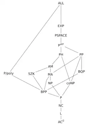

                                            https://complexityzoo.uwaterloo.ca/File:Really-important-inclusions.png
Note that $\mathsf{P}^{\mathsf{PP}}$ contains $\mathsf{PH}$ (by Toda's theorem), and $\mathsf{P}^{\mathsf{PP}}$ in turn is contained in $\mathsf{PSPACE}$. Both $\mathsf{PH}$ and $\mathsf{PSPACE}$ are describable in terms of polynomial-time alternating Turing machines 1, 2. Thus, such a machine with "direct state access" would indeed be as powerful as a polynomial-time non-deterministic Turing machine (in particular, a polynomial-time alternating Turing machine).
