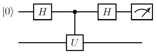

The key to understanding many quantum protocols and circuits is in the following circuit: enter image description here
This is especially true in the case where $U^2=I$, such that $U$ has eigenvalues $\pm1$. You can readily calculate that if the input, $|\psi\rangle$, of the second qubit has an amplitude $\alpha_+$ for being supported on the $+1$ eigenspace, then at the end of the algorithm, the probability of the first qubit being in the $|0\rangle$ state is $|\alpha_+|^2$.
So, consider the case of $U$ being swap. Swapping twice is certainly the identity, so swap has $\pm1$ eigenvalues. You'll also agree that two copies of the same state, when swapped, are the same as the input, so they correspond to a $+1$ eigenvalue. $$ \text{SWAP}\cdot|\psi\rangle|\psi\rangle=|\psi\rangle|\psi\rangle $$ The more different the two input states, the greater the difference between the input and the output of the swap, i.e. the less support there is on the $+1$ eigenspace there is, and the more likely you are to get the 1 outcome on measurement: $$ |\psi\rangle|\phi\rangle=\frac{1}{2}(|\psi\rangle|\phi\rangle+|\phi\rangle|\psi\rangle)+\frac{1}{2}(|\psi\rangle|\phi\rangle-|\phi\rangle|\psi\rangle) $$ In the equation above, I've split the input state into two terms: those from the symmetric (+1 eigenvalue) subspace and those from the antisymmetric (-1 eigenvalue) subspace. The lengths of the two vectors convey the probability amplitudes for being found in either subspace.
