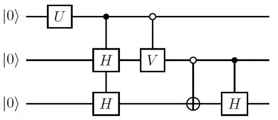

These strategies are perhaps conceptually simpler to understand than amplitude amplification, and work well if the amplitude you're trying to de-amplify is small enough. However, if the amplitude you're trying to amplify is too small, you won't do any better than the scaling resulting from amplitude amplification, and you'd be much better off seeing if you can change the circuit that's producing your state so that you don't have so much of the $|000\rangle$ component in the first place. For instance, in your example, instead of applying $H^{\otimes 3}$, you'd find a slightly more complicated circuit such as enter image description here where $U|0\rangle=(\sqrt{3}|0\rangle+2|1\rangle)/\sqrt{7}$ and $V|0\rangle=(|0\rangle+\sqrt{2}|1\rangle)/\sqrt{3}$.
