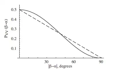

A compact proof of the CHSH inequality based on a hidden variabele can be found in the article Entangled photons, nonlocality and Bell inequalities in the undergraduate laboratory.
