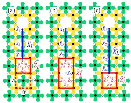

1 Cell Movement
The steps to move qubit in only 1 cell are:
1 - Finish full-cycle finish in all array
2 – before next cycle start – instruct software – "don’t mesure Z stab below"
3 – Also 2 X stabs are converted – 4 CNOTs -> 3
4 – Get X6 (measure X of Q6) used to track erros + influence new X_L
5 – turn on the Z stab above + arms of X stabs
6 – perform surface code cycle
7 – wait (d-1) cycles to establish stab value in time
L Cells Movement
Multi_cell movement, done very quick because you turn the stabilizers off very quickly, in total $d+1$ cycles (2 for the turn on and off, + $(d-1)$ to stabilize fault-tolerance), and not dependent on the length of movement $L$. The time per each stabilizer cycle is limited mainly by the measurement time. All you have to make sure that your $\epsilon$ - the rate of physical failure, will be below the threshold
refer to the article "Surface codes: Towards practical large-scale quantum computation" to see more details
Ron Cohen
  • 1,194
  • This is an example of a standard way to move the logical qubit. Which is perfectly reasonable, but in the question I do specify that I'm not interested in the standard ways of moving the qubits but rather in the fundamental limits. For example, by repeatedly distilling Bell pairs instead of moving important data, you can use error detection instead of just error correction. Which should be more efficient. Or you could reduce the code distance of the surface code then concatenate on a block code in order to reach an ultimately better coding rate. – Craig Gidney Feb 21 '22 at 10:41
