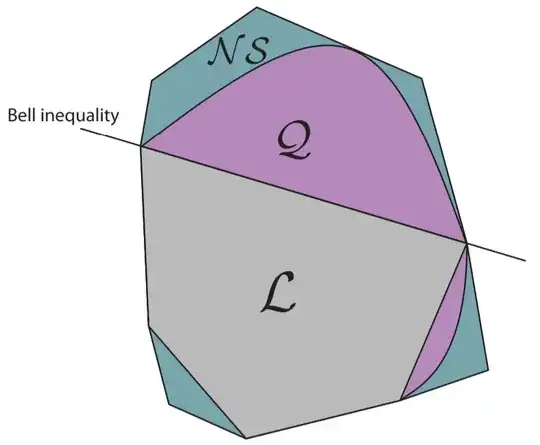

One can consider different restrictions imposed on a physical theory and study the corresponding set of possible behaviours. A first natural assumption is to require a theory to be no-signalling, which means that it doesn't allow for faster-than-light communication. The set $\mathcal{NS}$ of no-signalling behaviours is strictly larger than the set $\mathcal Q$ of quantum behaviours. In the context of CHSH inequalities, the boundary between $\mathcal{NS}$ and $\mathcal Q$ would be observable via Tsirelson's bound, which tells us that quantum mechanics cannot produce correlations such that $S>2\sqrt 2$ (where $S$ is the usual operator defined for CHSH inequalities). Similarly, the boundary between $\mathcal Q$ and the set $\mathcal L$ of local (classical) behaviours can be witnessed via the standard Bell's inequalities. See the following picture representing the relations between these different sets (taken from Brunner et al., pag. 7):
Have a look at Brunner et al.'s review (1303.2849) for more details.
