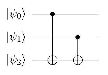

Since your desired operation is a non-injective function, you need a third qubit and a unitary acting on all three qubits. Using an operator on your two input qubits and tensoring this with ${\rm I}_2$ on the third qubit is not going to work as you might as well forget about the third qubit completely if that were the case.
By the way, the two matrices you present aren't unitary (${\rm U}{}^\dagger{\rm U}={\rm I}_4$ with $^\dagger$ the conjugate transpose does not hold), and tensoring a non-unitary matrix with ${\rm I}_2$ won't make it unitary either.
So, let's start over: take three qubits, define the first two as your input registers and the third as your output register. Then, what you want your operation to do, is this: $${\rm U}_f|000\rangle=|000\rangle\\ {\rm U}_f|010\rangle=|011\rangle\\ {\rm U}_f|100\rangle=|101\rangle\\ {\rm U}_f|110\rangle=|110\rangle$$ Note that to fully define ${\rm U}_f$, we would have to determine a desired output for the four other possible (computational basis) input states, $|\!*\!*1\rangle$. How we do this is entirely up to us! (As long as ${\rm U}_f$ remains unitary, of course.) So we can just choose something convenient, such as this: $${\rm U}_f|001\rangle=|001\rangle\\ {\rm U}_f|011\rangle=|010\rangle\\ {\rm U}_f|101\rangle=|100\rangle\\ {\rm U}_f|111\rangle=|111\rangle$$ This has the following matrix form: $${\rm U}_f=\begin{bmatrix} 1&0&0&0&0&0&0&0\\ 0&1&0&0&0&0&0&0\\ 0&0&0&1&0&0&0&0\\ 0&0&1&0&0&0&0&0\\ 0&0&0&0&0&1&0&0\\ 0&0&0&0&1&0&0&0\\ 0&0&0&0&0&0&1&0\\ 0&0&0&0&0&0&0&1 \end{bmatrix}$$ Intuitively, this unitary is constructed with two CNOT gates, which swap the third qubit $|0\rangle\to|1\rangle$ or $|1\rangle\to|0\rangle$ if and only if one of the first two qubits is in a $|1\rangle$ state:
You can check that multiplying the matrices of the two CNOTs indeed gives the same ${\rm U}_f$.

Your bit strings $x$ in the case when you specify $2$ bits are $00$, $01$, $10$, $11$. Now you want to output the result in another bit/qubit.
Whether the outpit bit/qubit is initialized as $0$ or $1$ should not change your unitary operation. The only thing changing is the initial quantum state your system is onto where you apply the unitary operation representing your function.
In this case, the implementation is straightforward. This is a first CNOT with first qubit of register $x$ as control and the output qubit as target followed by another CNOT with the second qubit of $x$ as control. If you input $x=00$, nothing happens. If $x=01$ or $10$, you apply one CNOT which adds $1$ to the target (definition of CNOT). If $x=11$, the two CNOTs are applied so you add $1$ to the target twice and $1 + 1 = 0$ when having one output bit.
To get the unitary, you can just take the unitary matrix of the CNOT, tensor product with the identity matrix (but respect the order when you write). You do this for the first CNOT giving you one unitary $U_1$, then the second giving $U_2$ and finally multiply $U_2 U_1$ to get your unitary operator.

  • Very nice lecture. I am also interested in knowing how to build circuits and you do explain that pretty nicely. In particular, you show how I could break the job into two parts, $U_1$ and $U_2$, composing them to get the desired result. Well done! Thank you. – R. Chopin Oct 20 '18 at 16:20
  • $\newcommand{\qr}[1]{|#1\rangle}$ Actually I haven't made it to verify this. We have three q-bits involved here --- call them $\qr{x}, \qr{y}, \qr{z}$ where $\qr{x}$ is on the top wire and $\qr{z}$, on the bottom wire. I can get the unitary of the second CNOT: $I_2 \otimes CNOT$ where I_2 represents doing nothing to $\qr{x}$. But how can I get the first unitary if the control q-bit is $\qr{x}$ and the target is $\qr{z}$. It's as if I needed to tensor product $I_2$ in the middle. I don't know what to do here. I'd appreciate if you expand your answer to as to take this into account. – R. Chopin Oct 23 '18 at 18:47
  • @R.Chopin Done :) – cnada Oct 24 '18 at 03:38
