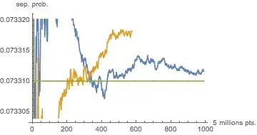

Here is a plot of estimates based upon two quasirandom sequences (one using $\alpha_0=0$ and one [the indicated longer one, using $\alpha_0 =\frac{1}{2}$] in the terminology of Roberts) along with the line $\frac{629}{8580}$.
