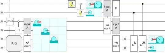

I tested this out in Quirk by embedding each qutrit into two qubits, and I get a simular result to you, where in addition to the cyclic shift fixup and the phasing operation you need to transpose states 1 and 2. Presumably there's some simple change to the circuit that fixes this, such as picking a different F, but I did't check too hard to see if it was possible.
Here's the circuit (and in the simulator itself):
trit teleportation
I've put displays throughout the circuit to have a better idea that it's working. In the bottom left area the blue rectangle with the three circles along its diagonal is showing that, yes, we're in the 00+11+22 state.
In the top middle I'm preparing some state to teleport. It doesn't really matter what it is, so I used gates that keep changing what they're doing. The important bit is that the blue rectangle here looks the same as the one in the bottom right, indicating the state moved.
In the bottom right you can see the fixups being applied. The cyclic shift (-A mod 3), the mystery transpose (implemented by the swap), and then the phasing operations.
I didn't include the measurements, but if you add some before the controls in the top right and just before the Input A of the -A mod R operation the circuit will behave identically.

  • Craig this is fantastic. Not only did you answer my question, but now I know about this simulator too. Thank you so much! – Joe Oct 01 '18 at 13:38
