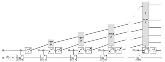

"Qubit recycling" refers to the fact that you can rearrange the phase estimation circuit so that $Q_{k}$ is measured and done with before you need to initialize $Q_{k+1}$, allowing a single qubit to iteratively play the roles of $Q_0, \dots, Q_{n-1}$. This reduces $n$ qubits of storage to 1 qubit of storage. Here's a diagram of phase estimation with qubit recycling:
enter image description here source: https://arxiv.org/abs/1706.07884
