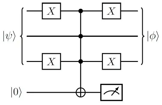

You're using some unusual notation and terminology that don't entirely fit. I'm assuming you question is that you are starting from a state $$ |\psi\rangle=3|000\rangle+4|001\rangle+5|010\rangle+6|011\rangle+7|100\rangle+8|101\rangle+9|110\rangle+10|111\rangle)/\sqrt{380} $$ and you want to convert it into $$ |\phi\rangle=3|000\rangle+4|001\rangle+6|011\rangle+7|100\rangle+8|101\rangle+9|110\rangle+10|111\rangle)/\sqrt{355}. $$ You have a vast range of options for how you might do this. By far the simplest is essentially the suggestion of TristanNemoz where you run a probabilistic protocol. In terms of a quantum circuit, this looks like enter image description here
and works provided the measurement gives the answer 0, which happens with probability $\frac{355}{380}=\frac{71}{76}$. The circuit is simple, and has the further advantage that you don't actually need to know what state $|\psi\rangle$ is, only the term that you want to knock out. The disadvantage, of course, is that it is probabilistic.

  • Thank you very much! I get the first circuit now. Regarding the second matrix, did you use an algorithm to find the unitary matrix that maps $\Psi$ to $\phi$, or do we just keep trying till we get the desired distribution? I suppose any arbitrary prescription of state vector distribution can in principle be prepared using the correct unitary matrix? – James Jul 19 '23 at 09:25
The projectors $\mathcal{M}_0=|010\rangle\!\langle010|$ and $\mathcal{M}_1=I-|010\rangle\!\langle010|$ define a measurement. Applying this measurement, you will get outcome $0$ with probability $\frac{5^2}{3^2+\cdots+10^2}=\frac{5}{76}$ and outcome $1$ with probability $\frac{71}{76}\approx93.42\%$.
If you get outcome $1$, then the resulting state will be the one that you want.
