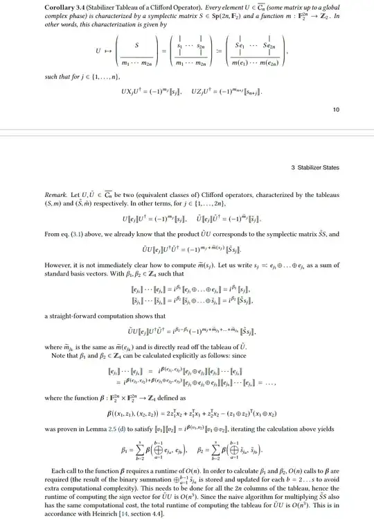

I'm writing my bachelor's thesis on this topic, and I have done some computations. Below is an extract from the text I'm writing.
As far as I know, I don't think the sign vectors can be very easily computed for qubits (but I believe it's easier for odd prime power dimensions), since in the qubit case, the function $\beta:\mathbb{F}_2^{2n}\to\mathbb{Z}_4$ below cannot be further simplified.
Note that for $v\in\mathbb{F}_2^{2n}$ with $v=(x,z)$ where $x,z\in\mathbb{F}_2^{n}$, I defined $$ [[v]] = [[(x,z)]] := i^{z^T x} X(x) Z(z) , $$ and the symbol $\oplus$ is for bit-wise binary addition.
Basically, it's the same argument as the comment above from M. Stern, or as in section 4.4 of Markus Heinrich's PhD thesis (https://kups.ub.uni-koeln.de/50465/).
Ooooscar
  • 111
  • I have also just implemented this $O(n^3)$ tableau multiplication (with the sign vector) in python, so it is possible. – Ooooscar Feb 27 '24 at 19:06
  • By the way, qiskit (https://github.com/Qiskit/qiskit/blob/stable/1.0/qiskit/quantum_info/operators/symplectic/clifford.py) already has a Python implementation for composing Clifford operators, and it's also the same idea. – Ooooscar Feb 28 '24 at 18:07
