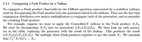

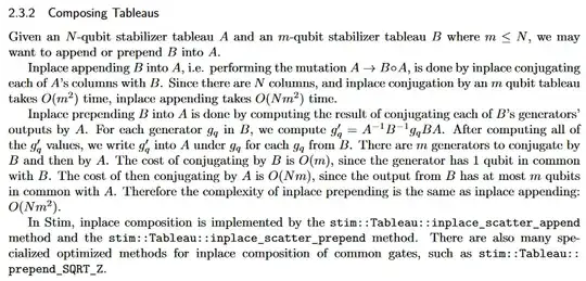

Applying an arbitrary $n$-qubit Clifford operation, represented as a stabilizer tableau, to an arbitrary $n$-qubit stabilizer state, also represented as a stabilizer tableau (or equivalently as a list of stabilizer generators), can be done in $O(\text{matmul}(n))$ time. It's just $n \times n$ matrix multiplication with a few extra steps.
As far as I know, no software for simulating Clifford stuff actually does fancy matrix multiplications. It all just does schoolbook matrix multiplication, which is $O(n^3)$ time. For example, that's what Stim does:
And you can even try it:

clearly the stabilizer part is not growing exponentially if it still takes one second at $n=1000$. And actually the majority of that time is probably going into generating the random states, which involves performing Gaussian elimination under the hood. If I make identity tableaus instead of random tableaus, it can do a 10K qubit tableau multiplication in a second.
