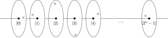

The nice thing of this picture above is that it can uniquely represent the state of any $n$-qubit quantum computer by marking exactly one point in all of the circles. More explicitly, any quantum state of a $n$-qubit quantum computer can be depicted in the above picture by drawing one cross ($\times$) in all of the circles. Conversely, any such drawing represents a quantum state, as long as the squares of the distances of the crosses to the center point sum to $1$. In other words, if we calculate all the distances of the marked points to the center points, then square these distances, and then add them all up, we require that the result equals $1$. An example state is shown below:

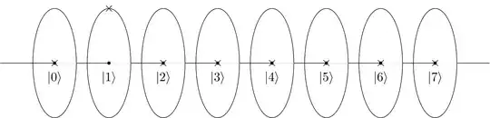

To that end, suppose that we have the $3$-qubit system in the following state, i.e., where the cross is all the way at the edge in the $|0\rangle$ circle, and all the others are exactly at the center. It is an exercise for the OP to check that indeed the square of the distances of the marked points to the center points sum to $1$. We refer to this state as the $|0\rangle$ state.

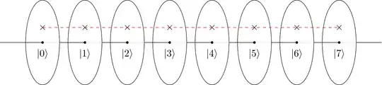

The question is now what happens to the quantum state when we apply the Quantum Fourier Transform. It turns out that, when the Quantum Fourier Transform is applied to the state shown above, the resulting state of the quantum system becomes:
Here I added the red dashed line passing through all the marked points just for extra convenience. All the marked points are on the exact same location in the circles, namely precisely above the center point at a height of $1/\sqrt{8}$.

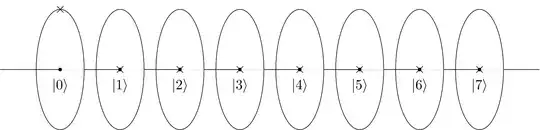

Similarly, we can have a look at the action of the Quantum Fourier Transform on other states. Consider for example the $|1\rangle$ state:

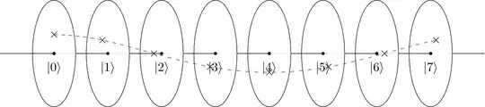

Now, if we apply the Quantum Fourier Transform, the resulting state becomes:
We can see that the resulting state becomes some kind of helix shape. Moreover, observe that if we were to add one extra circle to the right of the rightmost state, then the helix would complete exactly one revolution.

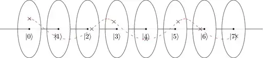

It turns out that the other states behave similarly under the Quantum Fourier Transform, but that the period of the helix changes. More precisely, if we start out with the state $|j\rangle$, then the number of revolutions that the Quantum Fourier Transform makes is $j$. I.e., if we consider the initial state $|3\rangle$, then we obtain the following image under the Fourier transform:
Here, we can easily see that the helix completes $3$ full revolutions if we were to add one more circle on the right hand side.
