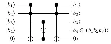

A CCCNOT gate is a four-bit reversible gate that flips its fourth bit if and only if the first three bits are all in the state $1$.
How would I implement a CCCNOT gate using Toffoli gates? Assume that bits in the workspace start with a particular value, either 0 or 1, provided you return them to that value.

I guess what you're looking for is the following circuit. Here, $b_1,b_2,b_3,b_4 \in \{0,1\}$, and $\oplus$ is addition modulo $2$.
Here, the fifth qubit is used as an auxiliary, or ancilla qubit. It starts at $|0\rangle$ and ends in $|0\rangle$ when the circuit is applied.
Let me elaborate on how this circuit works. The idea is to first of all check whether the first two qubits are in state $|1\rangle$. This can be done using a single Toffoli gate, and the result is stored in the auxiliary qubit. Now, the problem reduces to flipping qubit $4$, whenever qubits $3$ and the auxiliary qubit are in $|1\rangle$. This can also be achieved using one application of a Toffoli gate, namely the middle one in the circuit shown above. Finally, the last Toffoli gate serves to uncompute the temporary result that we stored in the auxiliary qubit, such that the state of this qubit returns to $|0\rangle$ after the circuit is applied.

    a source, or method used to derive the circuit, would be useful! – glS Jun 19 '18 at 19:43
    I know of no sources that explain how to design such circuits in a comprehensive manner. The sources I used when learning about quantum computing were the book by Nielsen and Chuang, and the lecture notes that can be found here: https://homepages.cwi.nl/~rdewolf/qcnotes.pdf, but these sources do not specifically focus on the design of quantum circuits. – arriopolis Jun 19 '18 at 19:47
    I did try to elaborate on how the circuit works a little more. Hope this helps in designing circuits similar to this one! :) – arriopolis Jun 19 '18 at 19:55
