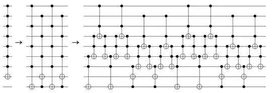

I've seen claims that a single ancillary bit suffices to make the Toffoli gate universal; is there a good reference for that?
See this blog post:
With a single ancilla, you can do an operation that swaps two states in the phase space. This lets you build any permutation, i.e. you get universality. There is the relevant caveat that I'm assuming that if you can do a Toffoli then "obviously" you can do a NOT gate. If you can't do a NOT gate then you need two ON ancillae to allow the Toffoli to act like a NOT.
