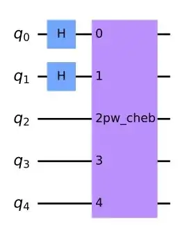

which should implement a piecewise approximation of the zero function on two qubits ... We can take a look of what the circuit looks like:
the first and second qubits are state qubits and I guess that the three others are ancillary qubits.
The initial state of the system is set to $\frac{1}{2} (|00\rangle+|01\rangle+|10\rangle+|11\rangle)$ so we may look at all possible results of the approximation.

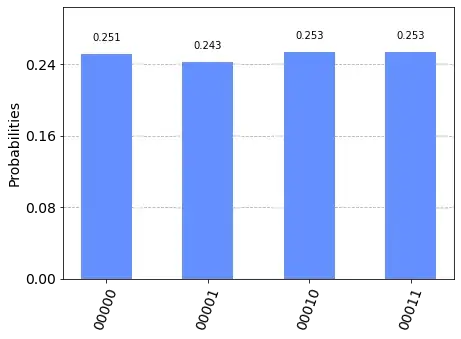

But while looking at measurements of the output qubits, I am facing weird results:
The third qubit is set to one, while the two first are unchanged. I tried a lot of different functions to understand how one can interpret the resulting qubits, but I still cannot figure out what the circuit does. Does anyone have an idea ?

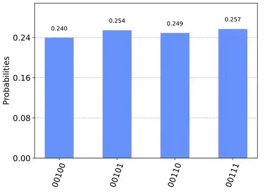

The source of the problem was numpy.polynomial.chebyshev.interpolate, which is used to approximate the input function but raises problems when approximating a constant function.
The code in Qiskit has been changed adding a special case for such functions and explaining how constant functions should be declared, i.e. as f_x = constant rather than with the lambda declaration.
The updated code now performs as expected:
import numpy as np
from qiskit import *
from qiskit.visualization import plot_histogram
from qiskit.circuit.library.arithmetic.piecewise_chebyshev import PiecewiseChebyshev
f_x, degree, breakpoints, num_state_qubits = 0, 1, [0], 2
pw_approximation = PiecewiseChebyshev(f_x, degree, breakpoints, num_state_qubits)
pw_approximation._build()

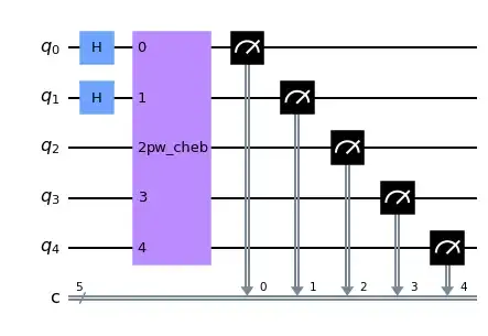

qc = QuantumCircuit(pw_approximation.num_qubits, pw_approximation.num_qubits)
qc.h(list(range(num_state_qubits)))
qc.append(pw_approximation.to_instruction(), qc.qubits)
qc.measure(list(range(pw_approximation.num_qubits)), list(range(pw_approximation.num_qubits)))
qc.draw(output='mpl')
backend = BasicAer.get_backend('qasm_simulator') # the device to run on
result = execute(qc, backend, shots=10000).result()
counts  = result.get_counts(qc)
plot_histogram(counts)
And here is the link to the PR in case you want to check its status.
