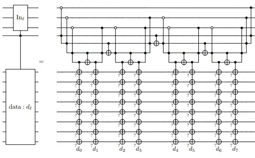

If $x$ is only 5 bits long, your best bet is almost definitely to just encode all the possible answers into a QROM circuit and do a lookup.
Here's a QROM circuit diagram from https://arxiv.org/abs/1805.036621:
And here's Q# source code for constructing a lookup circuit, from ancillary files of https://arxiv.org/abs/1905.076821.

  • Thank you for the explanation, comments and references Craig! Would this be reasonable for higher numbers of bits in $x$, say 10 or 20? And if not, do you know if there are implementations for generic multi-bit values of $x$ that use things like polynomial approximations or any other technique as like that? – sheesymcdeezy Mar 25 '21 at 20:53
    @RajivKrishnakumar For 20 I'd probably do an interpolated lookup, and maybe try to extract factors of 2 to canonicalize the problem because factors of 2 can be handled by manual shifts. – Craig Gidney Mar 25 '21 at 21:39
    @RajivKrishnakumar You could also break $e^{x}$ into $e^{x_1 + x_2/2^5 + x_3 / 2^10 + x_4 / 2^15}$ where each $x_k$ value was a 5 qubit integer, separately look up each, and multiply them all together. – Craig Gidney Mar 30 '21 at 23:14
