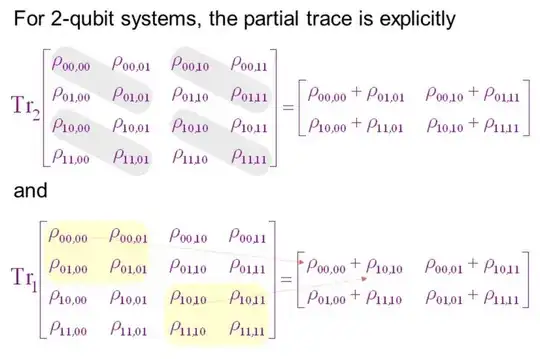

A really easy way to remember partial traces in the computational basis for 2-bit systems is the following:
This picture is not mine, it is from Prof. Michele Mosca's Lecture Notes at University of Waterloo; publicly available.
