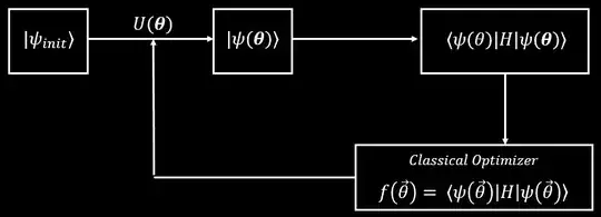

This is when the Variational Quantum Eigensolver (VQE) came out. It tries to mitigate the some of this circuit depth issue to the number of circuits one would need to perform... through the use of variational principle.
Notice that calculate $\langle \psi(\theta) | H| \psi (\theta) \rangle$ you have to use many quantum circuits as $H = \sum_{i}^{poly(N)} \alpha_i P_i$ and so $\langle H\rangle_{\psi(\theta)} = \sum_{i}^{poly(N)} \alpha_i \langle P_i \rangle$ but we can only measure in the computational basis so many circuits will be needed to do this calculation. Note that the decomposition of the Hamiltonian $H$ to Pauli strings is only in $O(poly(N))$ for the certain problems (like the molecular electronic Hamiltonian). But for a general Hamiltonian, you would need $4^N$ terms.
